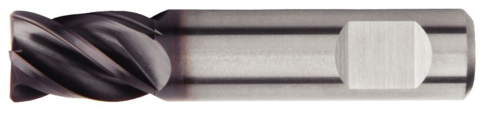

GOmill™ • Chamfered • 4 Flutes • Weldon® Shank • Metric
Solid Carbide End Mill for Roughing and Finishing of Multiple Materials
Material Number4032821
ISO Catalog IDUEDE0800B4AHANSI Catalog IDUEDE0800B4AH
GOmill Solid Carbide End Mill - Chamfered - 4 Flutes - Weldon Shank - Metric - Grade KC643M - 4032821 - Kennametal.com
$98.98/each
  • Tool Dimensions: Flute Configuration: 4Tool Dimensions: Flute Configuration: 4
Drawings for 4032821
GradeKC643M
Adapter Style Machine SideWeldon Short
[D1] Effective Cutting Diameter8 mm
[D1] Effective Cutting Diameter0.315 in
[D] Adapter / Shank / Bore Diameter8 mm
[D] Adapter / Shank / Bore Diameter0.315 in
[AP1MAX] 1st Maximum Cutting Depth11 mm
[AP1MAX] 1st Maximum Cutting Depth0.433 in
[L3] Usable Length11 mm
[L3] Usable Length0.433 in
[L] Overall Length 43 mm
[L] Overall Length 1.693 in
[BCH] Corner Chamfer Width 0.4 mm
[BCH] Corner Chamfer Width 0.016 in
[Z] Number of Flutes4
KC643M
KC643M
Coated fine-grain grade with PVD multilayer (AlTiN). KC643M™ is a very thin and hard PVD coating particularly suited for cutting steel, cast iron, stainless steel (wet), and titanium (wet). This grade can be used for materials with hardness up to 52 HRC.
  • Economic solid carbide end mill with short style shanks, saving expensive carbide.
  • Not recommended for reconditioning.
  • Extremely stable cutting conditions due to short design.
  • Center cutting for plunging and ramping operations.
  • Unequal flute spacing for chatter-free machining at highest feed rates.
