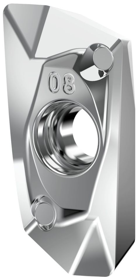

Mill 1-14™ • Carbide Insert • EDCT-E.LDJ • Light Machining of Aluminum
Shoulder milling insert with two cutting edges per insert, precision ground

GradeKC422M
[LI] Insert Length 17.5 mm
[LI] Insert Length 0.689 in
[L10] Insert Cutting Edge Length15.267 mm
[L10] Insert Cutting Edge Length0.6011 in
[S] Insert Thickness4.5 mm
[S] Insert Thickness0.1772 in
[W] Insert Width 8.42 mm
[W] Insert Width 0.332 in
[BS] Corner Facet Length 0.99 mm
[BS] Corner Facet Length 0.039 in
[Rε] Corner Radius 2.375 mm
[Rε] Corner Radius 0.094 in
Average Chip Thickness [HM]0.03 mm
Average Chip Thickness [HM]0.0012 in
Cutting Edges per Insert2
KC422M
KC422M
The PVD TiB2 coating is very wear resistant. Together with hard coating and a tough substrate, this is an excellent combination for medium to roughing applications in aluminum <10% silicon and other non-ferrous materials.
  • Precision ground insert with polished rake face
