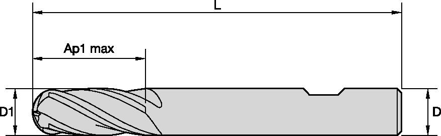

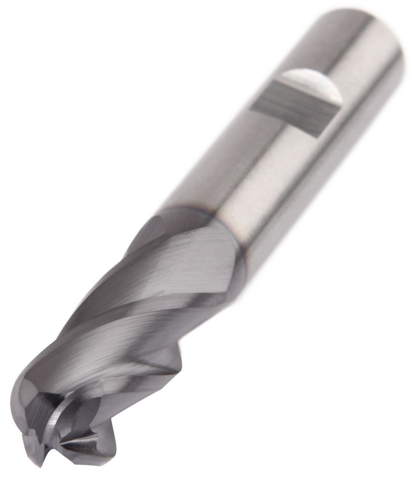

GOmill™ GP • Ball Nose • 4 Flutes • Weldon® Shank • Metric
General Purpose Solid Carbide End Mill
Objednací číslo101242183
Vlastnosti a výhody
- Solid carbide end mill with stepped parallel shank according to DIN 6527.
- Solid carbide end mill with excellent cost-benefit ratio.
- Eccentric relief increases cutting edge stability for long tool life and high surface quality.
- Eccentric relief eases regrinding and reduces reconditioning cost.
- Center cutting for plunging and ramping operations.
Side Milling/Shoulder Milling: Ball Nose
3D Profiling
DIN number 6527
Tool Dimensions: Flute Configuration: 4
Helix Angle: 30°
Corner Style: Ball Nose
