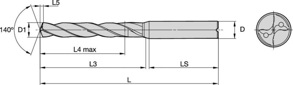

Grade | KCU15 |
[D1] Drill Diameter M | 6.15 mm |
[D1] Drill Diameter M | 0.2421 in |
[L] Overall Length | 91 mm |
[L] Overall Length | 3.5827 in |
[L3] Flute Length | 53 mm |
[L3] Flute Length | 2.0866 in |
[L4] Maximum Drilling Depth | 43 mm |
[L4] Maximum Drilling Depth | 1.6929 in |
[L5] Drill Point Length | 1.03 mm |
[L5] Drill Point Length | 0.0406 in |
[LS] Shank Length | 36 mm |
[LS] Shank Length | 1.4173 in |
[D] Adapter / Shank / Bore Diameter | 8 mm |
[D] Adapter / Shank / Bore Diameter | 0.315 in |

Dimension
Dimensões para brocas inteiriças de metal duro Kennametal (Série B*)
mm | CURTA* | LONGA* | EXTRA LONGA** | |||||||||
Ø | DIN 6535 | ~3 x D | ~5 x D | ~8 x D | ||||||||
D1 mín | D1 máx | D | LS min | L | L3 | L4 | L | L3 | L4 | L | L3 | L4 |
1,000 | 1,400 | 4 | 28 | 58 | 7 | 5 | 58 | 9 | 6 | 58 | 12 | 10 |
1,401 | 1,900 | 4 | 28 | 58 | 9 | 6 | 58 | 12 | 9 | 58 | 18 | 15 |
1,901 | 2,300 | 4 | 28 | 58 | 13 | 9 | 58 | 18 | 14 | 66 | 26 | 22 |
2,301 | 2,990 | 4 | 28 | 58 | 17 | 12 | 58 | 22 | 17 | 66 | 30 | 25 |
3,000 | 3,750 | 6 | 36 | 62 | 20 | 14 | 66 | 28 | 23 | 78 | 40 | 33 |
3,751 | 4,750 | 6 | 36 | 66 | 24 | 17 | 74 | 36 | 29 | 87 | 49 | 41 |
4,751 | 6,000 | 6 | 36 | 66 | 28 | 20 | 82 | 44 | 35 | 94 | 56 | 48 |
6,001 | 7,000 | 8 | 36 | 79 | 34 | 24 | 91 | 53 | 43 | 105 | 67 | 57 |
7,001 | 8,000 | 8 | 36 | 79 | 41 | 29 | 91 | 53 | 43 | 110 | 72 | 61 |
8,001 | 10,000 | 10 | 40 | 89 | 47 | 35 | 103 | 61 | 49 | 122 | 80 | 68 |
10,001 | 12,000 | 12 | 45 | 102 | 55 | 40 | 118 | 71 | 56 | 141 | 94 | 79 |
12,001 | 14,000 | 14 | 45 | 107 | 60 | 43 | 124 | 77 | 60 | 155 | 108 | 91 |
14,001 | 16,000 | 16 | 48 | 115 | 65 | 45 | 133 | 83 | 63 | 171 | 121 | 101 |
16,001 | 18,000 | 18 | 48 | 123 | 73 | 51 | 143 | 93 | 71 | 185 | 135 | 113 |
18,001 | 20,000 | 20 | 50 | 131 | 79 | 55 | 153 | 101 | 77 | 200 | 148 | 124 |
20,001 | 22,000 | 20 | 50 | 141 | 86 | 60 | 167 | 112 | 85 | 217 | 162 | 136 |
22,001 | 25,000 | 25 | 56 | 153 | 95 | 65 | 184 | 126 | 98 | 238 | 180 | 150 |
* D1 20mm conforme a norma DIN 6537K | ||||||||||||
* D1 | ||||||||||||
** Padrão Kennametal |
