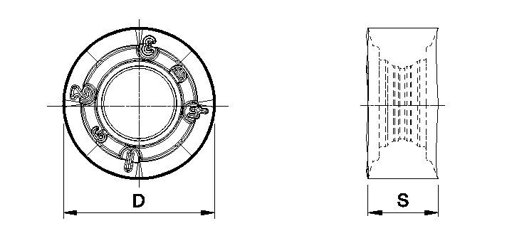

| 제품 번호 | 5517778 |
| ISO 카탈로그 ID | RNGJ10T3M0SGDJ |
| ASI 카탈로그 ID | RNGJ10T3M0SGDJ |
| Grade | KCSM30 |
| [D] Insert IC Size | 10 mm |
| [D] Insert IC Size | 0.394 in |
| [S] Insert Thickness | 3.931 mm |
| [S] Insert Thickness | 0.1548 in |
| Average Chip Thickness [HM] | 0.088 mm |
| Average Chip Thickness [HM] | 0.0034 in |
| Insert Number of Indexes | 8 |
