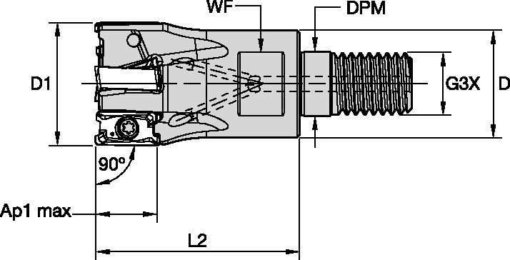

제품 번호 | 6139895 |
ISO 카탈로그 ID | M4D125L1105M16L175 |
ANSI 카탈로그 ID | M4D125L1105M16L175 |
[D1] Effective Cutting Diameter | 31.75 mm |
[D1] Effective Cutting Diameter | 1.25 in |
[D] Adapter / Shank / Bore Diameter | 29 mm |
[D] Adapter / Shank / Bore Diameter | 1.142 in |
[DPM] Pilot Diameter Machine Side | 17 mm |
[DPM] Pilot Diameter Machine Side | 0.669 in |
[G3X] Connection Thread Size External | M16 |
[L2] Head Length | 44.45 mm |
[L2] Head Length | 1.75 in |
[WF] Width of Flat | 24 mm |
[WF] Width of Flat | 0.943 in |
[AP1MAX] 1st Maximum Cutting Depth | 11 mm |
[AP1MAX] 1st Maximum Cutting Depth | 0.433 in |
Number of Inserts | 5 |
[Z] Number of Flutes | 5 |
Weight Pounds | 0.49 |
Max RPM | 29200 |
